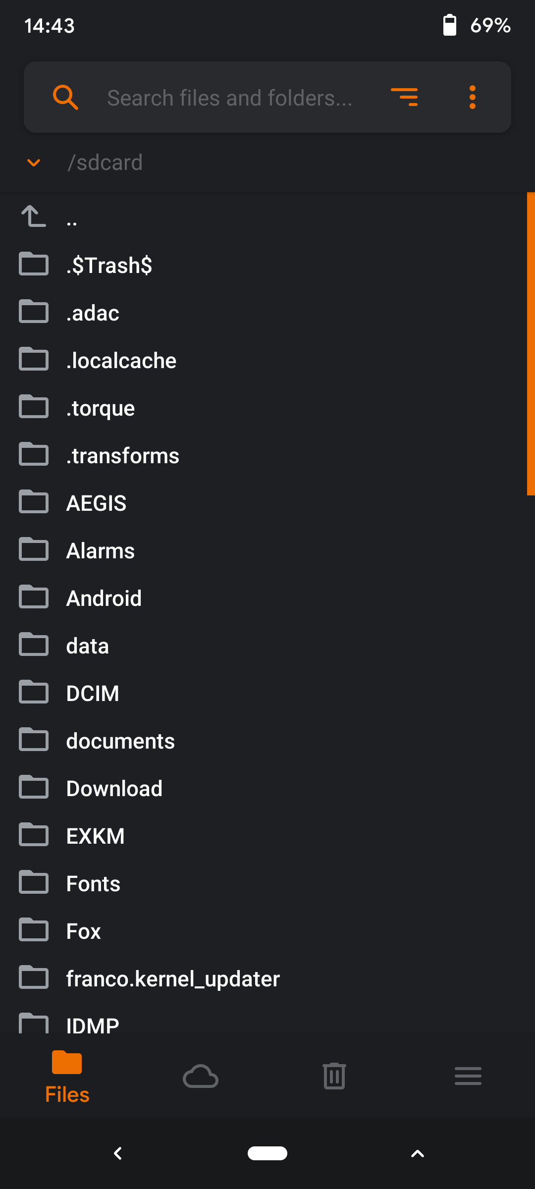

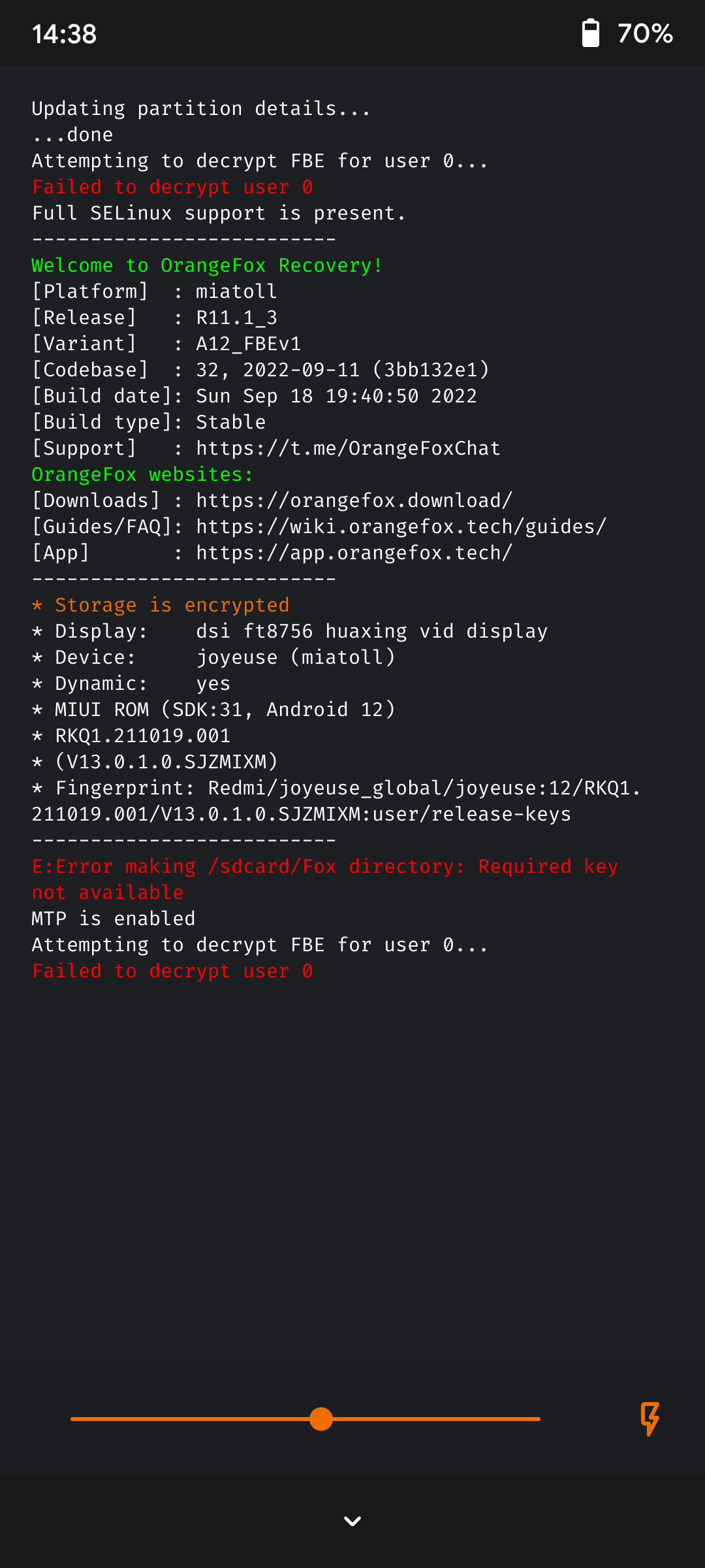

Here are some screenshots, probably can help you to understand what's going on:
OFox says that storage is encrypted. After I input the correct pattern OFox says FBEv1 decrypt was not successful:
Although as you can see my internal storage is decrypted and you can read the file/dir names.
PS: When I input a wrong pin or pattern then everything in internal storage and in /data are gibberish, you can't read proper file/dir names.
TL;DR: When I input a correct pin/pattern then everything in internal storage and in /data are readable but still I receive the very same error message in OFox.
I really-really can't explain it any better........ but a picture says a thousand words, so I hope the screenshots are helping..

So, you boot to OFox, it asks for a decryption pattern, I input the pattern, it says it doesn't work and after I hit the back button it still drops to the OFox menu and I can browse the files, I can manage backups, I can even go to the app manager in OFox and it sees all my apps, etc, so ___seemingly___ the pattern did work and it was able to decrypt + mount everything but still, there was an error message etc..
When I remove the pattern is doesn't ask for anything, just drops me to the file browser. When I add back the pattern and all my fingerprints it starting this again. Even after formating /data.
Hope this helps to understand the situation.
