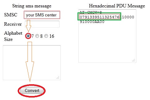

If someone is still wondering why the SMS centre number is some "weird" number - it's because it is in PDU hexadecimal form.
So here I found a converter that converts your SMS centre number to hex:
http://www.smartposition.nl/resources/sms_pdu.html#PDU_CONVERTER
INSTRUCTIONS on how to convert:
  • Enter your SMS centre number in the SMSC field,
  • leave the receiver and the message fields out,
  • select "Alphabet 7"
  • and click Convert!
  • Copy the first 16 numbers from the converted message as your SMS centre number in your phone.
