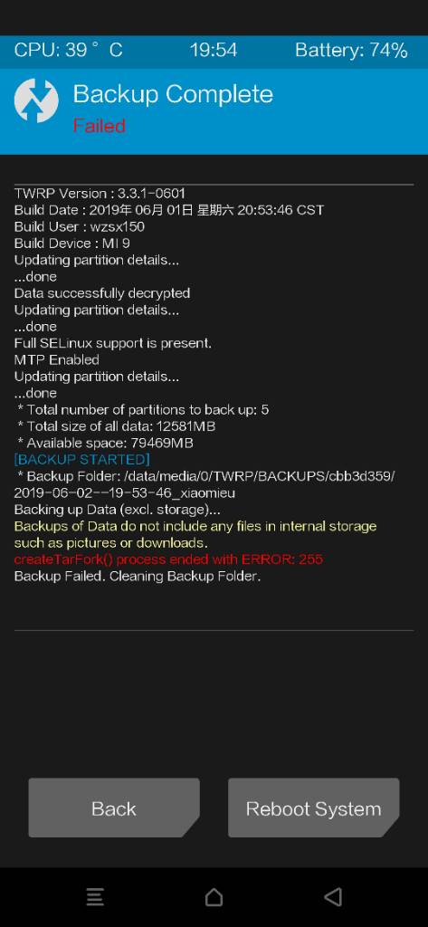

When I enter TWRP and enter the password, it decrypt successful but shows error while I backup data partition.

I found the way to solve the problem.
In terminal emulator, type su and get permission ,then type pm remove-user 999.
And then I can backup data.
If this is the solution can this be implemented auto in a update, perhaps?
