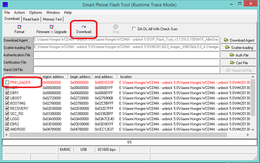

Restore stock firmware and lost IMEI/Baseband by SPFlash tool

the guy who made this thread has essentially posted a rom update - not an imei recovery. there is one native chinese app to recovery imei. search for MTK imei recovery. it's in chinese but works with two clicks.
i follow this giude but i get this error window
what should i do
what should i do
Maybe you have a fake phone. Look what under HINT is telling you !
It thinks your phone is a MT6572 and this should be MT6589.
Check with CPU-Z your CPU and resolution to make sure it is not a fake Hongmi.
i checked it and its fake :(:(:( so is there any thing i can do
thi
Ask your money back ?
Don't flash this rom on your phone.
