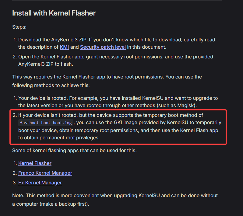

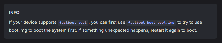

Aaa, I see. Sorry, you just flashed the kernel to .img. But why would you flash it again to .zip with kernel flasher? It doesn't make sense. I don't recommend it either. It's better to flash the .zip (Just replace your kernel) than to change the entire boot.img partition.
To answer your question is, they doesn't "flash" the boot, it just boot using the .img wild+ kernel. You can see in the kernelsu page, it does said that you could do it if supported.
In my situation, if i use "fastboot flash boot boot.img" to flash the boot img (fastboot flash boot android15-6.6.77-2025-03-boot.img), it just going to bootloop to fastboot back until i reflash the stock boot.img file. Hence the usage of booting into wild+ kernel first, then flashing the kernel using HorizonKernelFlasher. I know it doesnt really make much sense but hey, if it works, it works. Been using the kernel without any problem since i flash it using the method, so i can say that the method works, and it quite easy to follow.
edit: and yes if you boot into the .img wild+ kernel, you could grand root access.
edit 2: This method is actually mentioned in the kernelsu page
Reactions: Pelayo and Seras
