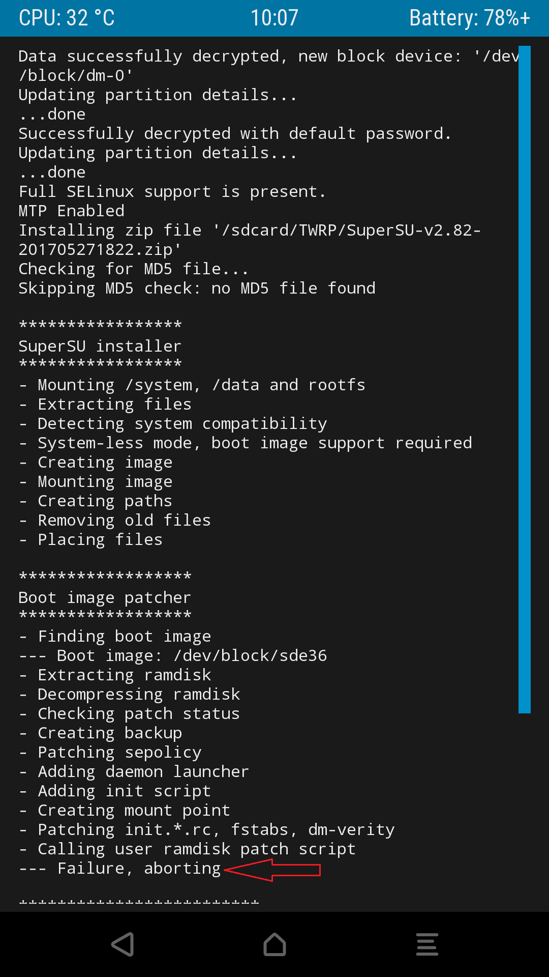

I can not get root access on this latest rom version!
I tried with the latest version (V2.82) and the previous version (V2.79), but without success.

I tried different versions of SuperSU installed from TWRP, followed by clearing cache_dalvik - without success.
I reinstalled xiaomi.eu Stable 8.5.3.0 (NAACNED) - problem not solved.
What I did before, different from other times: I tried to install 8.5.3.0 by Update app > Select the update package > Browse > xiaomi.eu_multi_MI5_V8.5.3.0.NAACNED_v8-7.0 > Confirm. The ROM has not been installed; I installed it later through the TWRP. Can this be the reason I can not get root access anymore?

I get the following error in TWRP (see attached screenshot). Any idea how can I solve it?
Update: Problem solved!
Cause: Magisk leftover
Solution: Manually deleted /data/custom_ramdisk_patch.sh
For that, I used File Manager inside TWRP (FM has root in TWRP).
