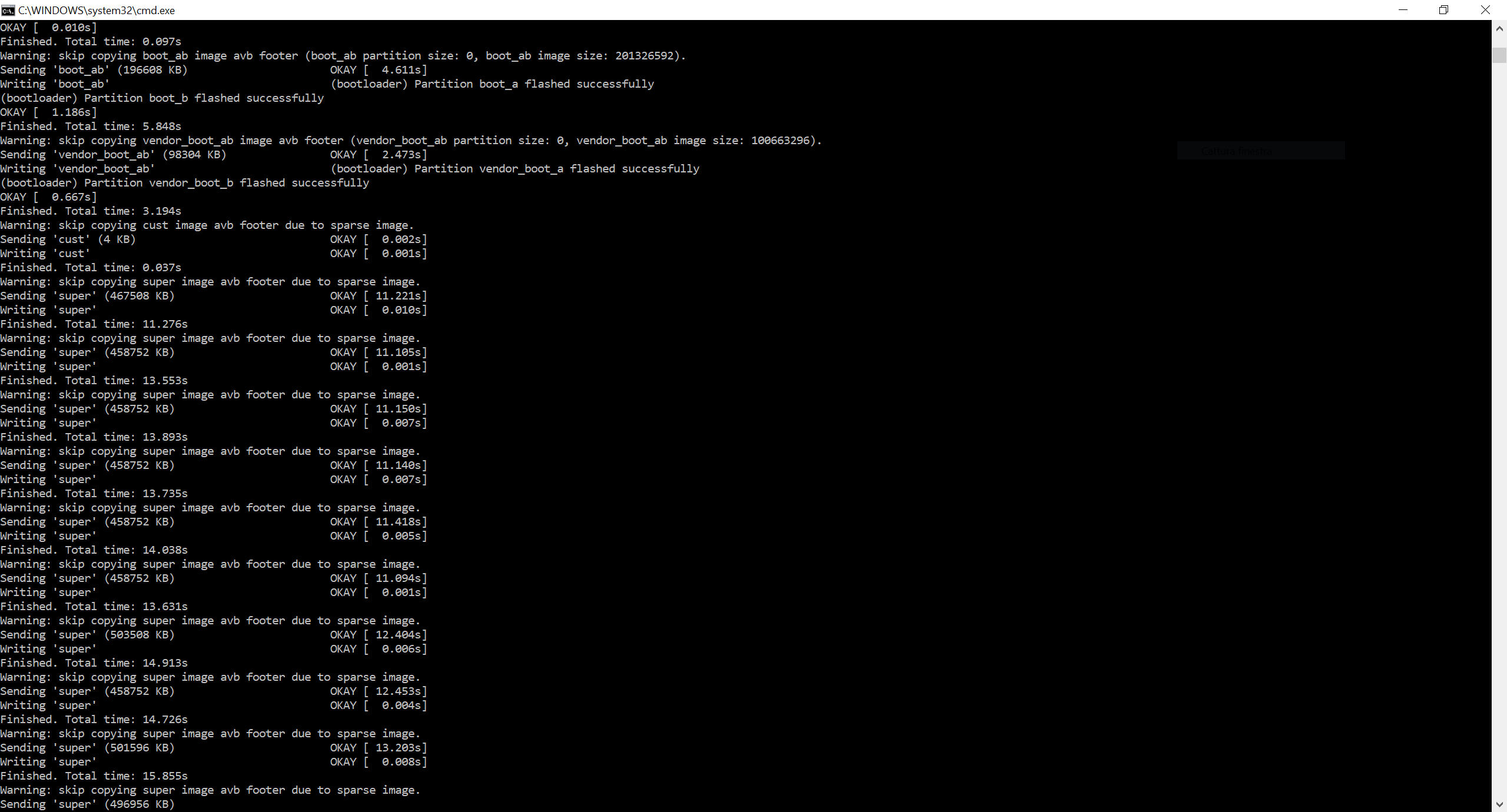

i don't know why when i try to update xiaomi 13 fuxi 1.0.17.0 it sais waiting for device and it's stucked like this. the pc sees the phone in fastboot mode. first time when happens this

Update with fastboot in Win works fine.
Open command prompt on your windows PC
go to the directory of your unzipped Rom
start the .bat file you need

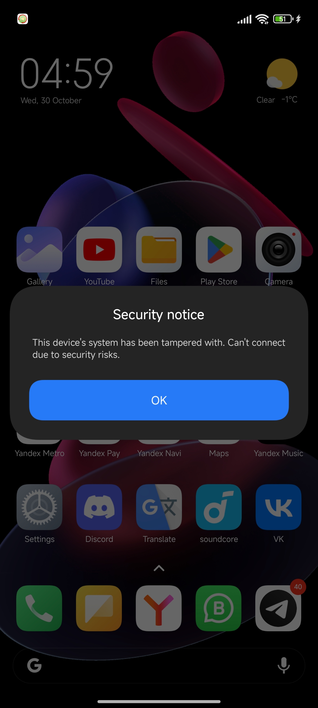

How fix it?
Fuxi last update non-root
Xiaomi interconnectivity

How fix it?
You can't fix it.
