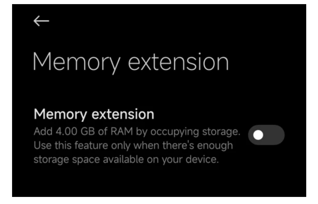

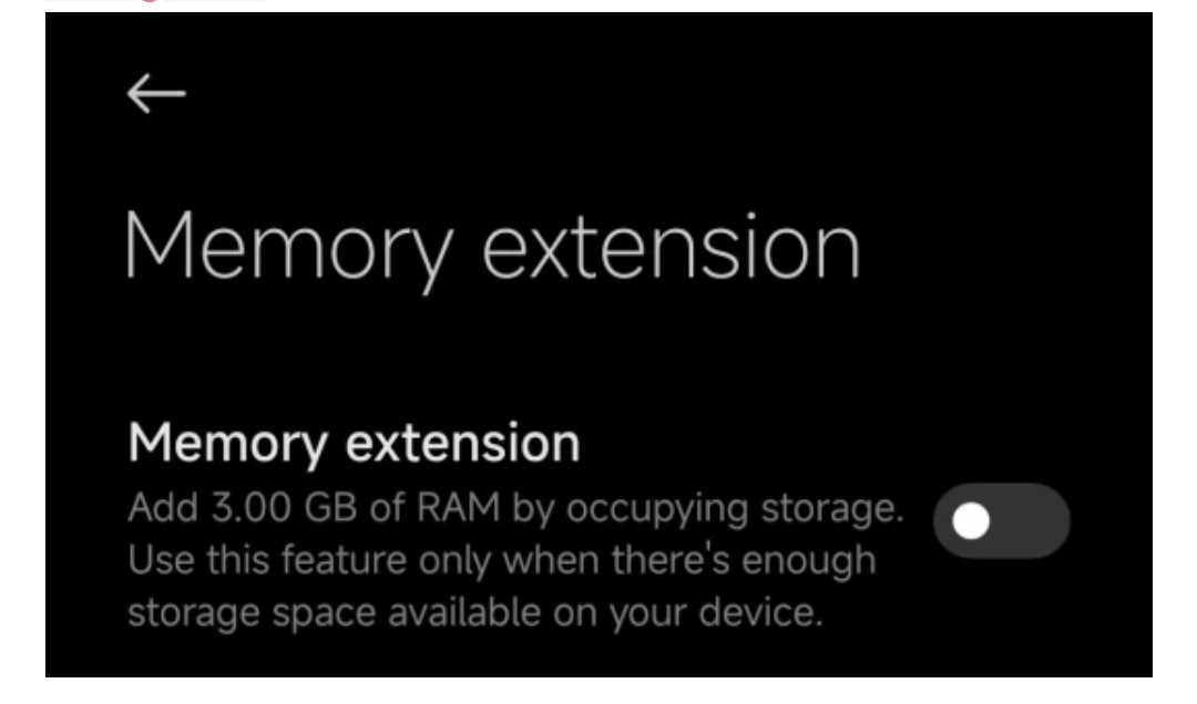

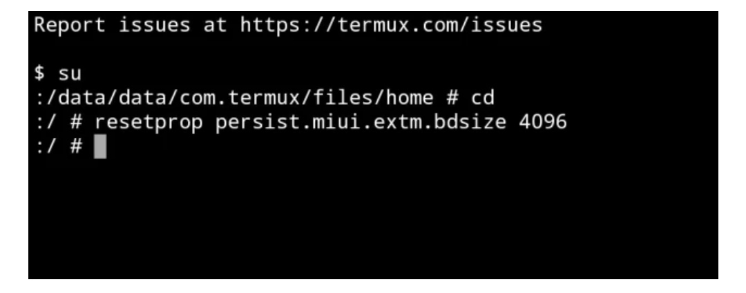

As you can see, before we start, I have only 3 GB of memory extension available. Now, we will change the extension size by doing the process below. But first, u must disable the memory extension then reboot.
Install Termux for Google Play Store.
Once it installs, open it.

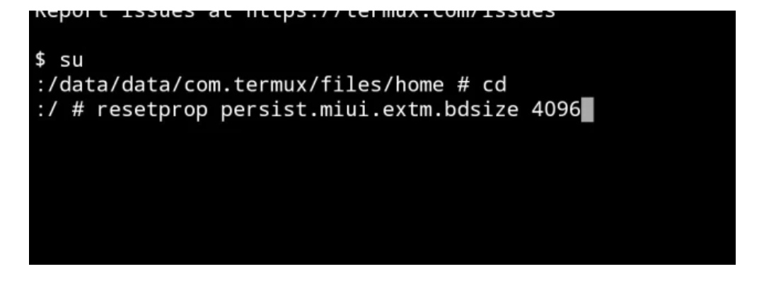

Type "su -c resetprop persist.miui.extm.bdsize 4096".
The Termux will ask for root access. Grant it, as it’s needed for this process.
“4096” is where your value goes. Whatever you set here, MIUI will use that amount of storage to add into RAM.
Once you did it, it won’t output anything. This is normal.

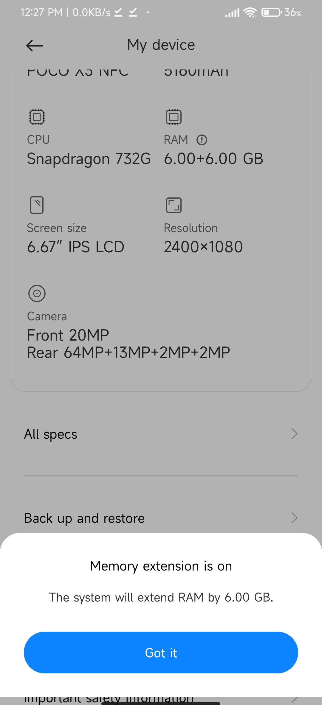

Reboot the device.

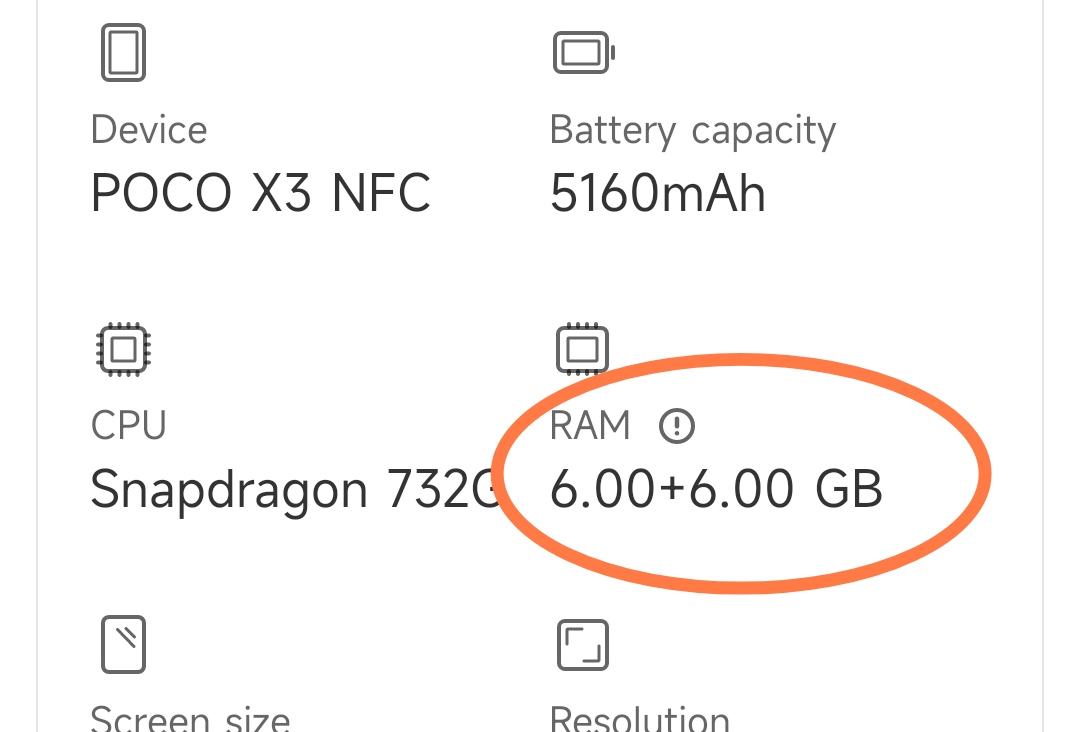

Enter settings again to check if it’s applied.
And that’s it you succesfully did Increase Memory Extension guide!

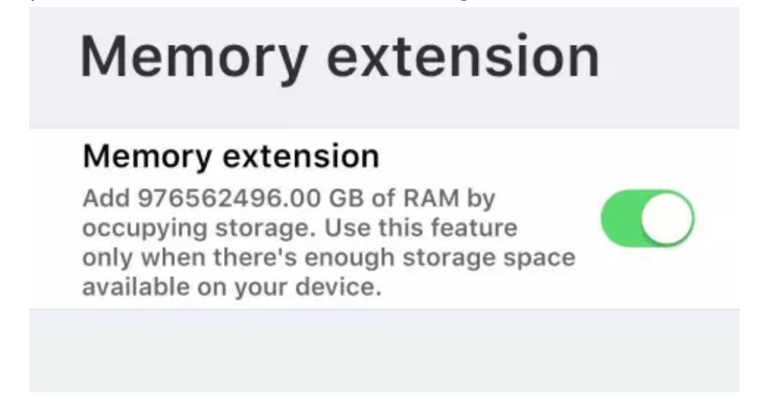

As this value let’s you to put anything in there,
please don’t abuse it into too high values.
As you can see in the picture above, we tried to abuse the value in another device. Although it might seem as working, after 5 minutes, device completely froze and gone into a bootloop, which left us with erasing all data in the device to fix it. Please don’t abuse the value or you might even need to do a factory reset.

This works in the following devices:
POCO X3/NFC in Xiaomi.eu and Global Stock rom
Redmi Note 10 (mojito) in Xiaomi.eu (I don't know if it works in global stock rom)
