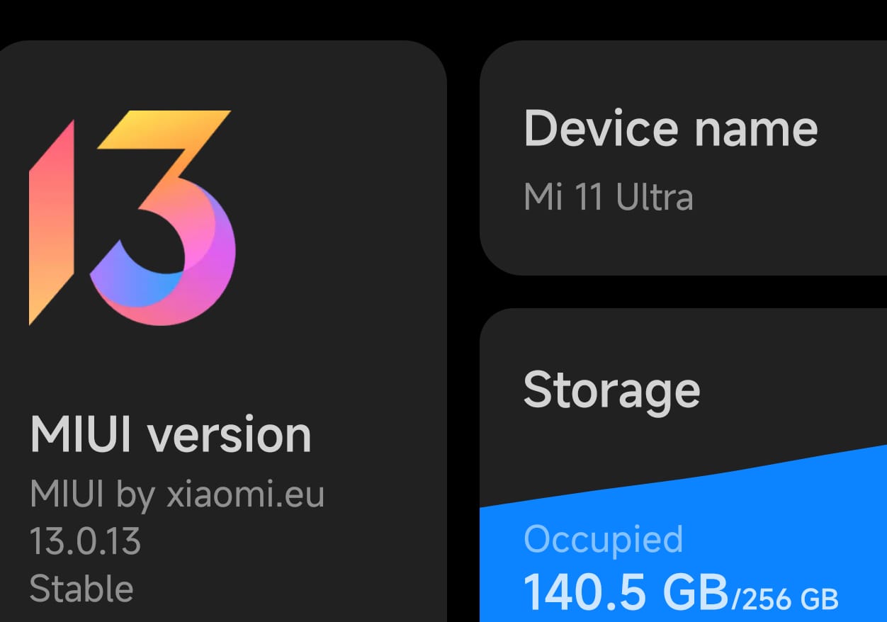

can someone please explain how to upgrade from miui 13 stable without data loss?
You will not lose data when updating. (a deposit is always a good idea)
The procedure is written in the first post of the thread and also in the Update app.
Xiaomi devices on Android 12/13 via Fastboot:
- Download our ROM zip file
- Unpack downloaded zip file in the PC using WinRAR
- Connect to PC via USB cable
- Run fastboot installation script from unpacked zip according your PC operating system:
--- For Windows OS - windows_fastboot_update_rom.bat
--- For Linux - linux_fastboot_update_rom.sh
--- For MacOS - macos_fastboot_update_rom.sh

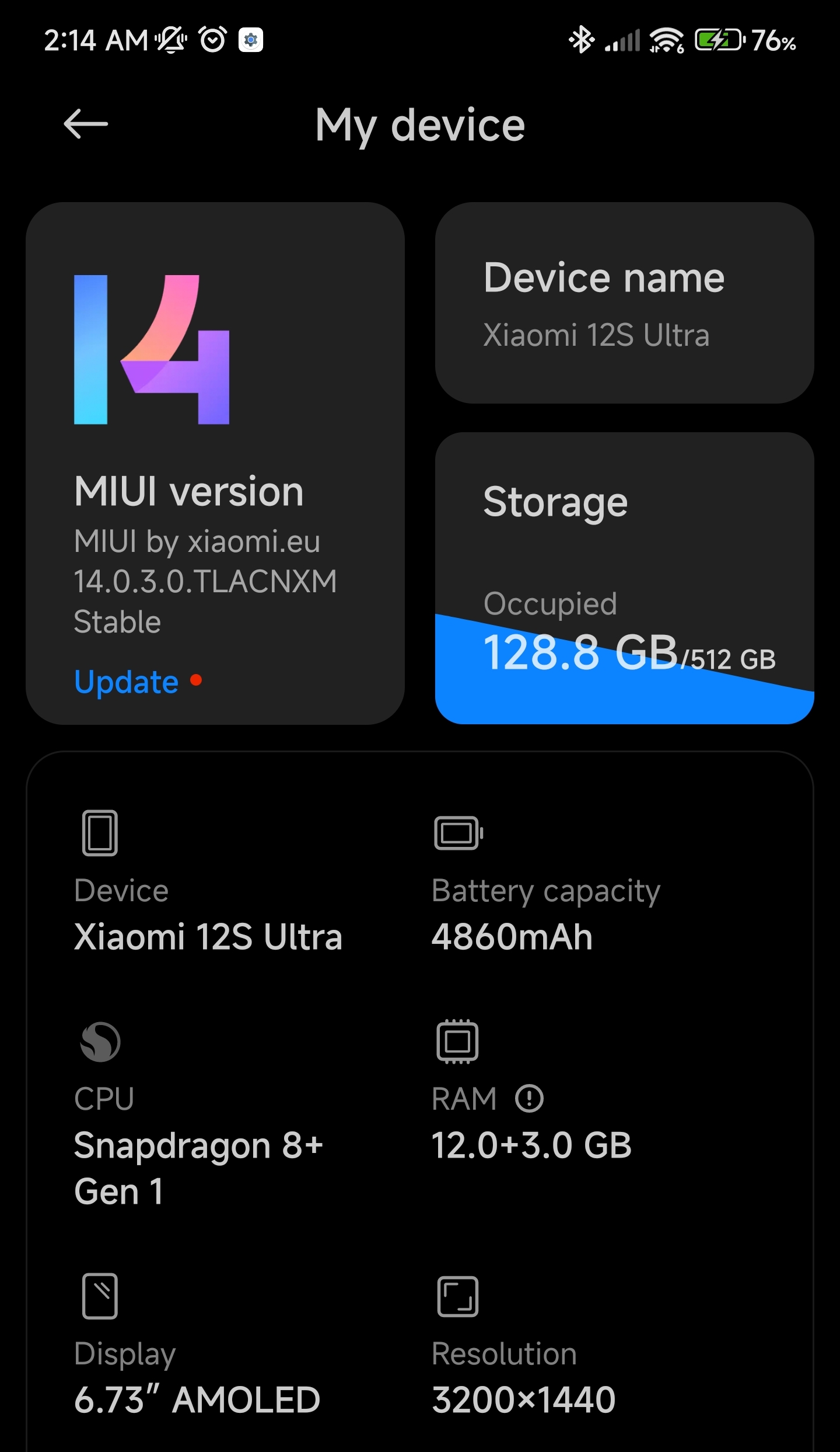

Just updated to v14.0.3.0 no problem's
Update everything works but message app was freezing like everyone else mentioned so I just flashed back to v14.0.2.0 in fastboot and now messaging back working.

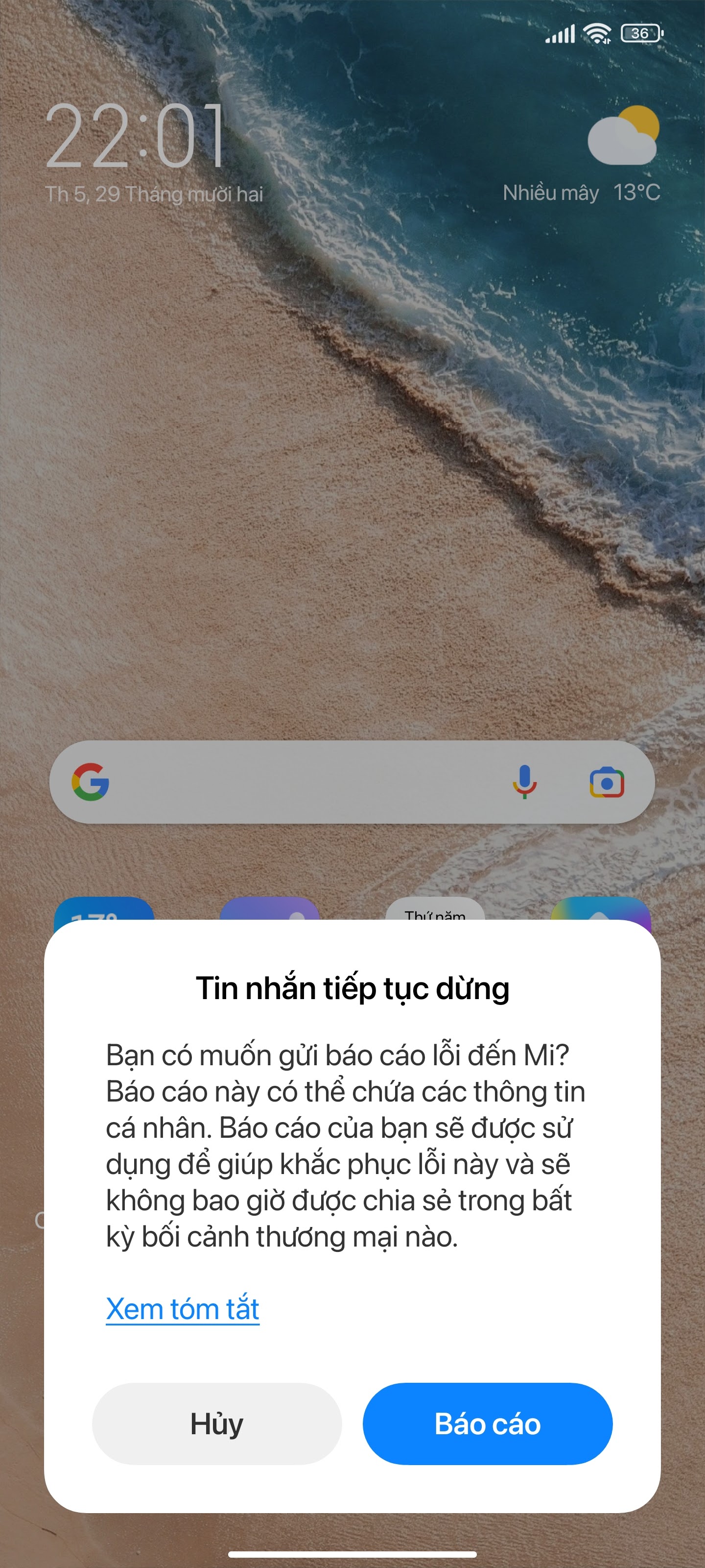

Xiaomi 12s Ultra
Update 14.0.3 and sms app crash

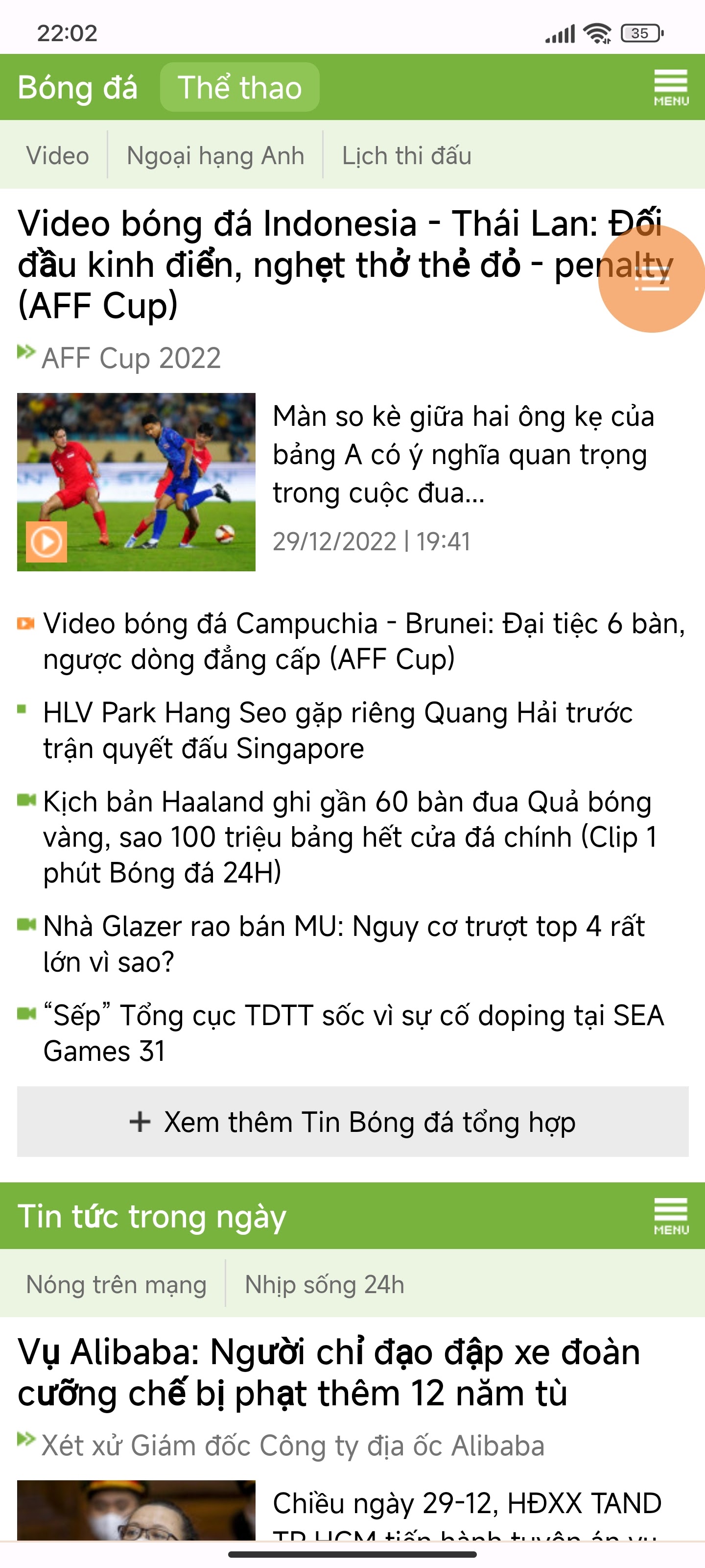

Vietnamese still doesn't display normally in 3rd party apps and webview, how can i fix it ?

Update on the sms app issue:
I followed the advice on this forum, and downgraded to 14.0.2.0 by using fastboot and selecting windows_fastboot_update_rom.bat this resolved the issue

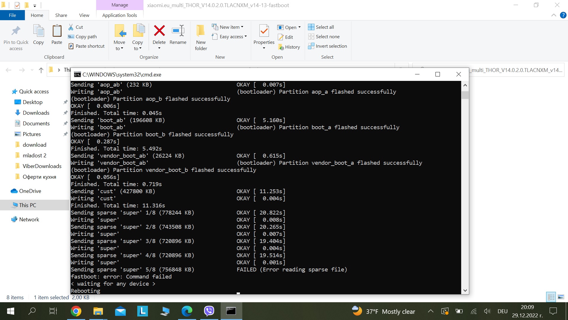

Hi friends,
I have just tried to update my 12s ultra to xiaomi.eu_multi_THOR_V14.0.2.0.TLACNXM_v14-13-fastboot.
Unfortunately came to this message and got freezed in fastboot mode. Tried down and power off, only power off, but I can not switch on the phone.
Sending sparse 'super' 4/8 (720896 KB) OKAY [ 19.514s]
Writing 'super' OKAY [ 0.001s]
Sending sparse 'super' 5/8 (756848 KB) FAILED (Error reading sparse file)
fastboot: error: Command failed
< waiting for any device >
Rebooting
Could somebody help me to solve this issue?

Hi friends,
Rebooting
Thank you in advance.
Long as your in fastboot you can try the flash again.

use WinRAR to unpack fastboot zip
Hi, I unpacked it via winrar. Finally I sucseed to go to twrp mode and to reinstall the older version of miui 13. Than the phone switchwed on without any problems.
After that I went again in fastboot mode, made the same to install the Miui 14 and the same happened:
Rebooting
The phone freezes in fastboot mode.
Any suggestions how can I install the newer version?
Rebooting
Did you install the driver's for your computer
