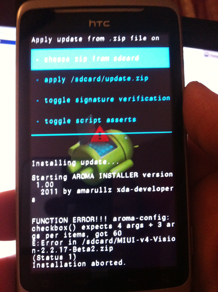

Hi. I have problems with my desire z when I'm trying to update from MIUI-v4-Vision-2.2.3-Alpha3 to MIUI-v4-Vision-2.2.17-Beta2. I receive an error message . Somebody help! Thanks.
