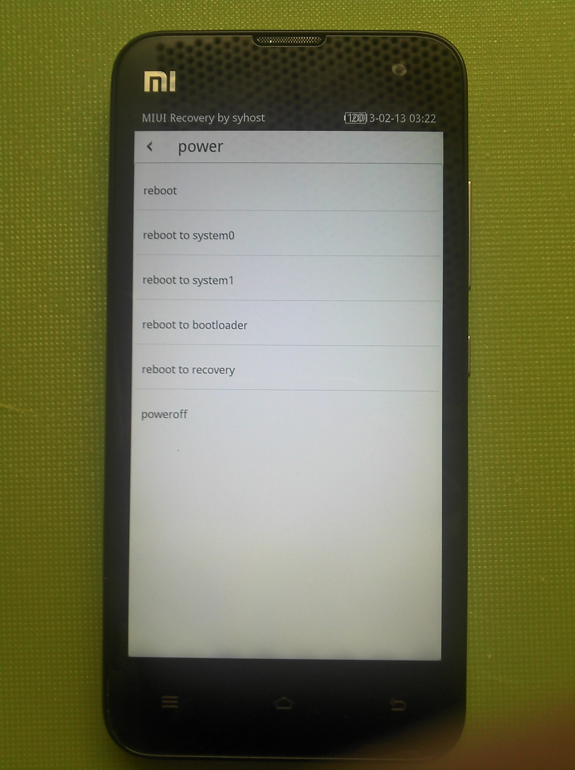

You can reboot into system0 and system1 just like on stock-recovery.

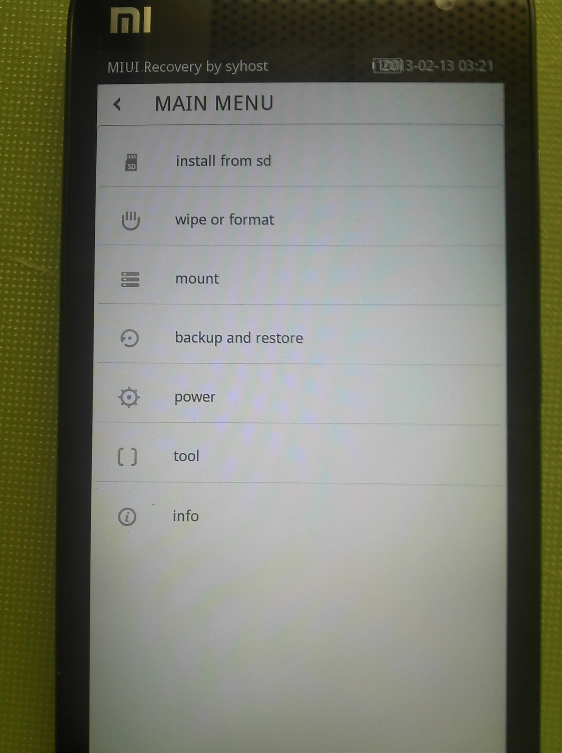

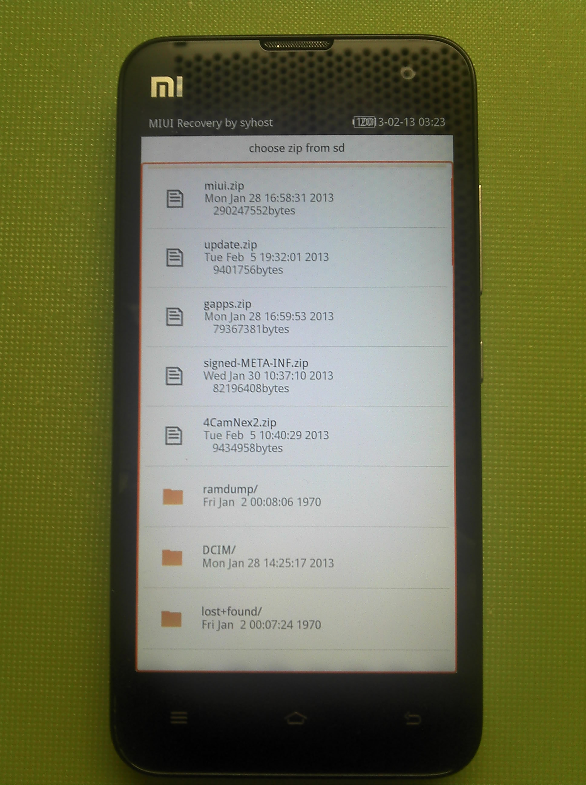

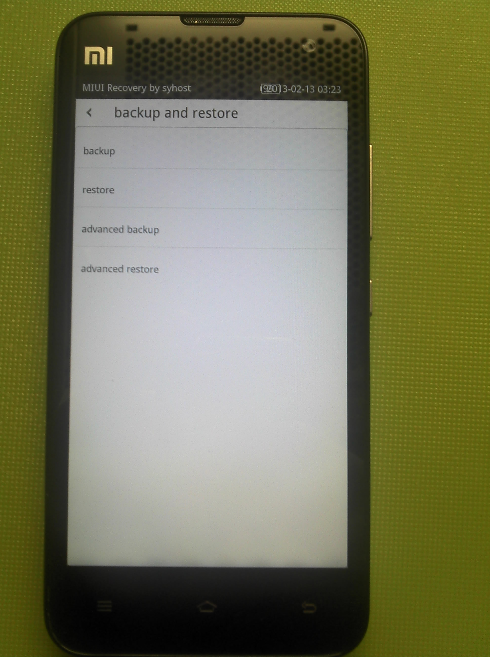

Screenshots:

back up and restore works well. data wipe works well. Not sure why it has option for format and wipe...Great job M1cha.
