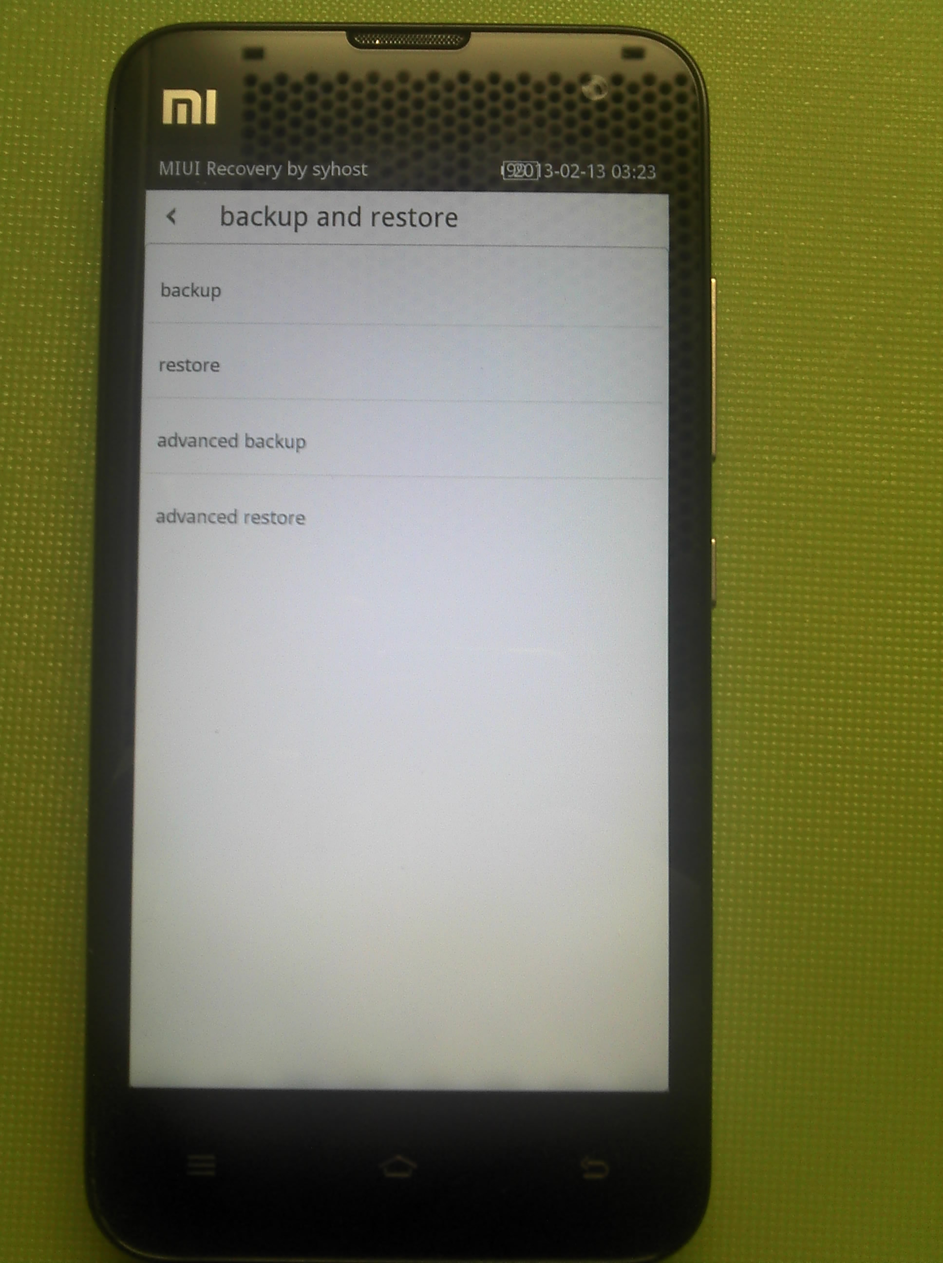

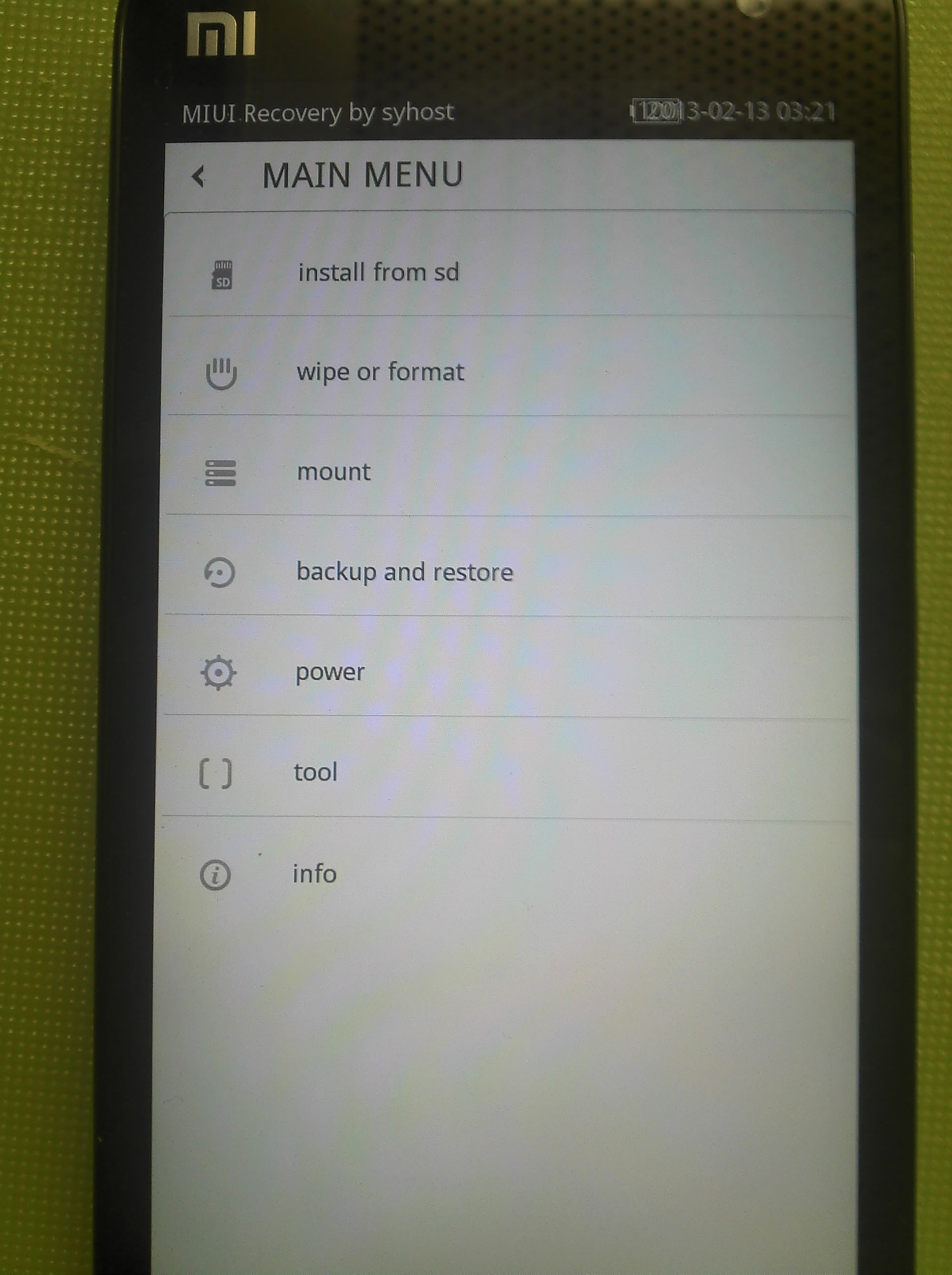

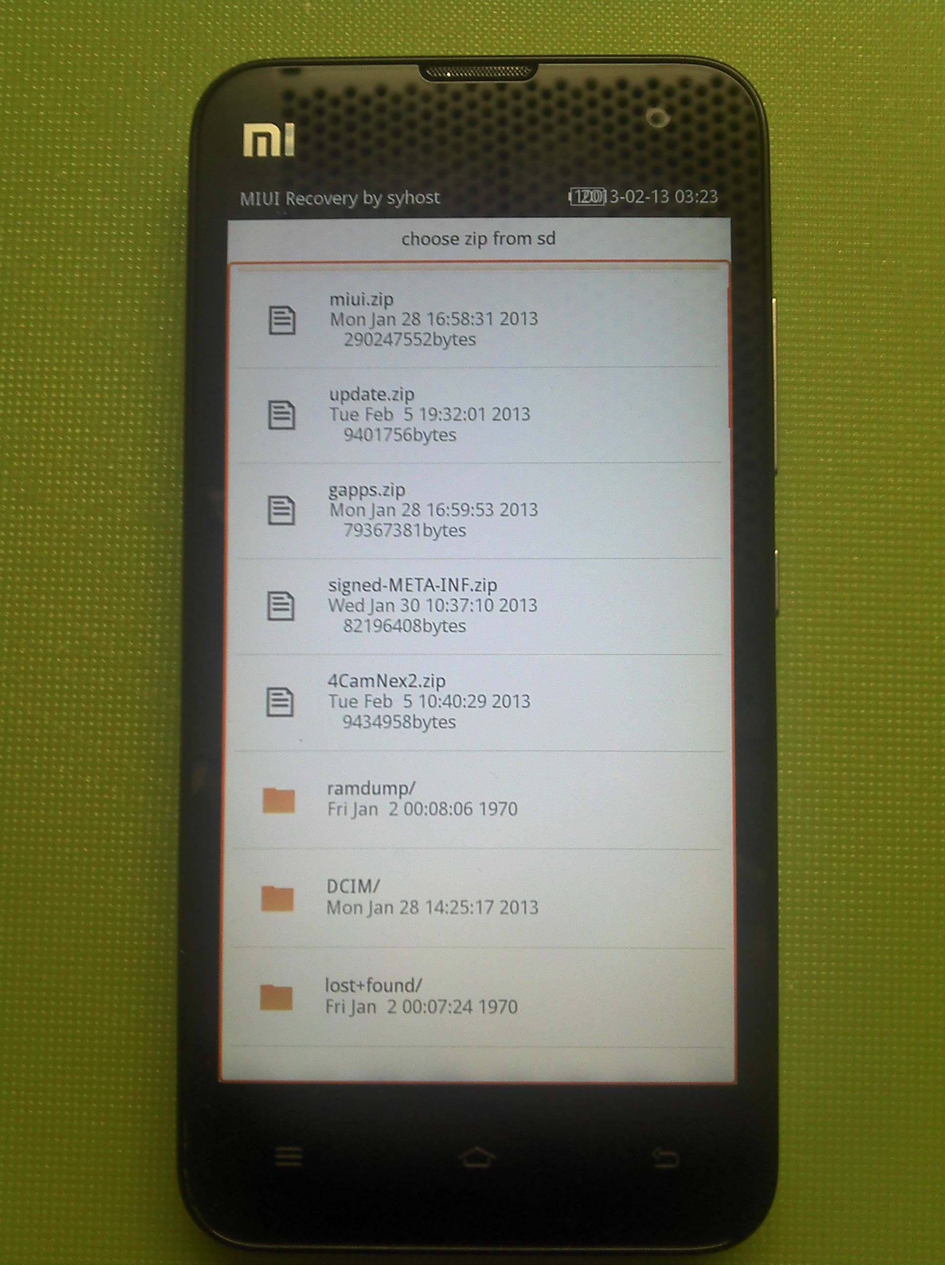

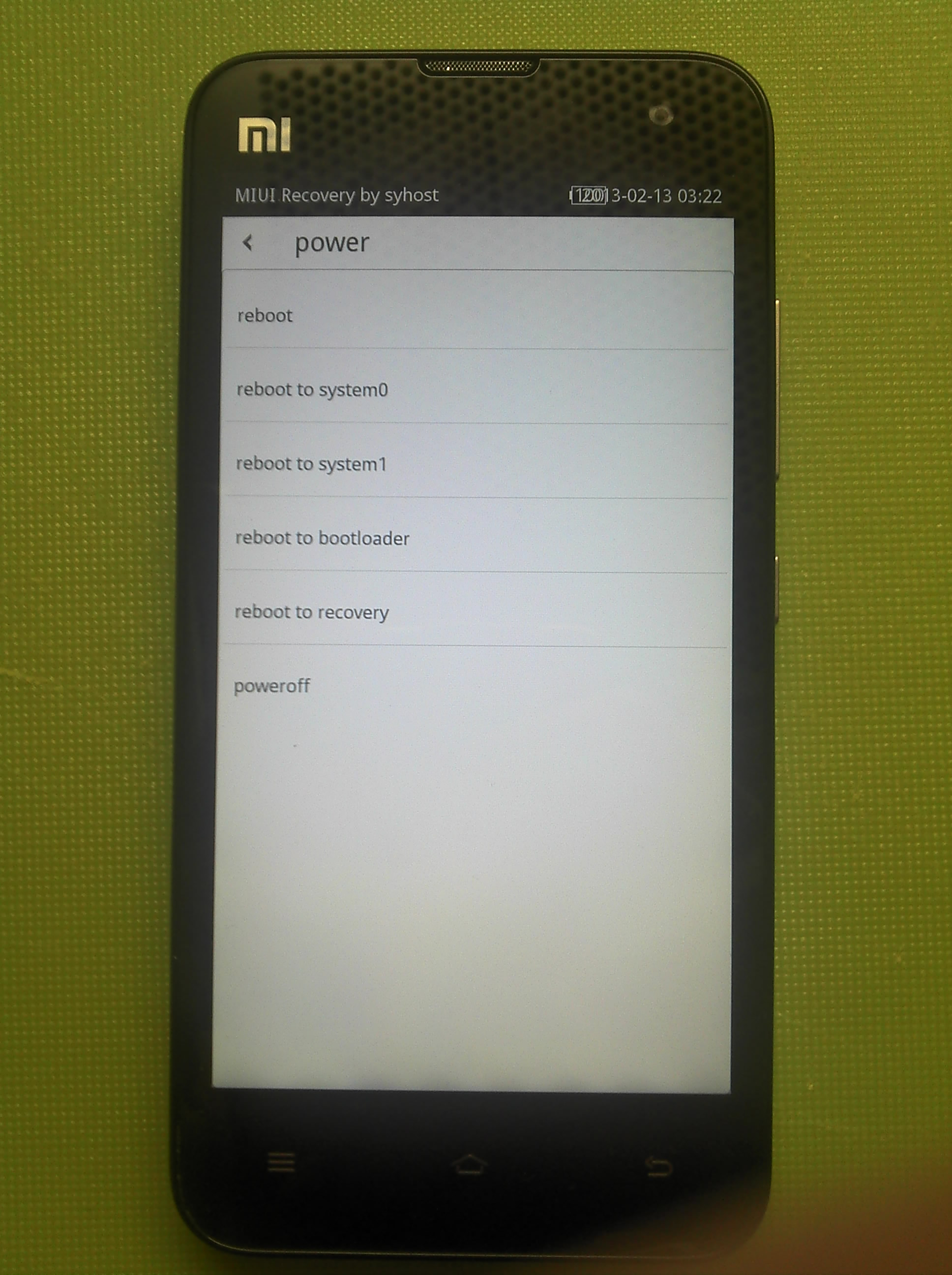

Screenshots:
View attachment 5205 View attachment 5208View attachment 5206View attachment 5207
