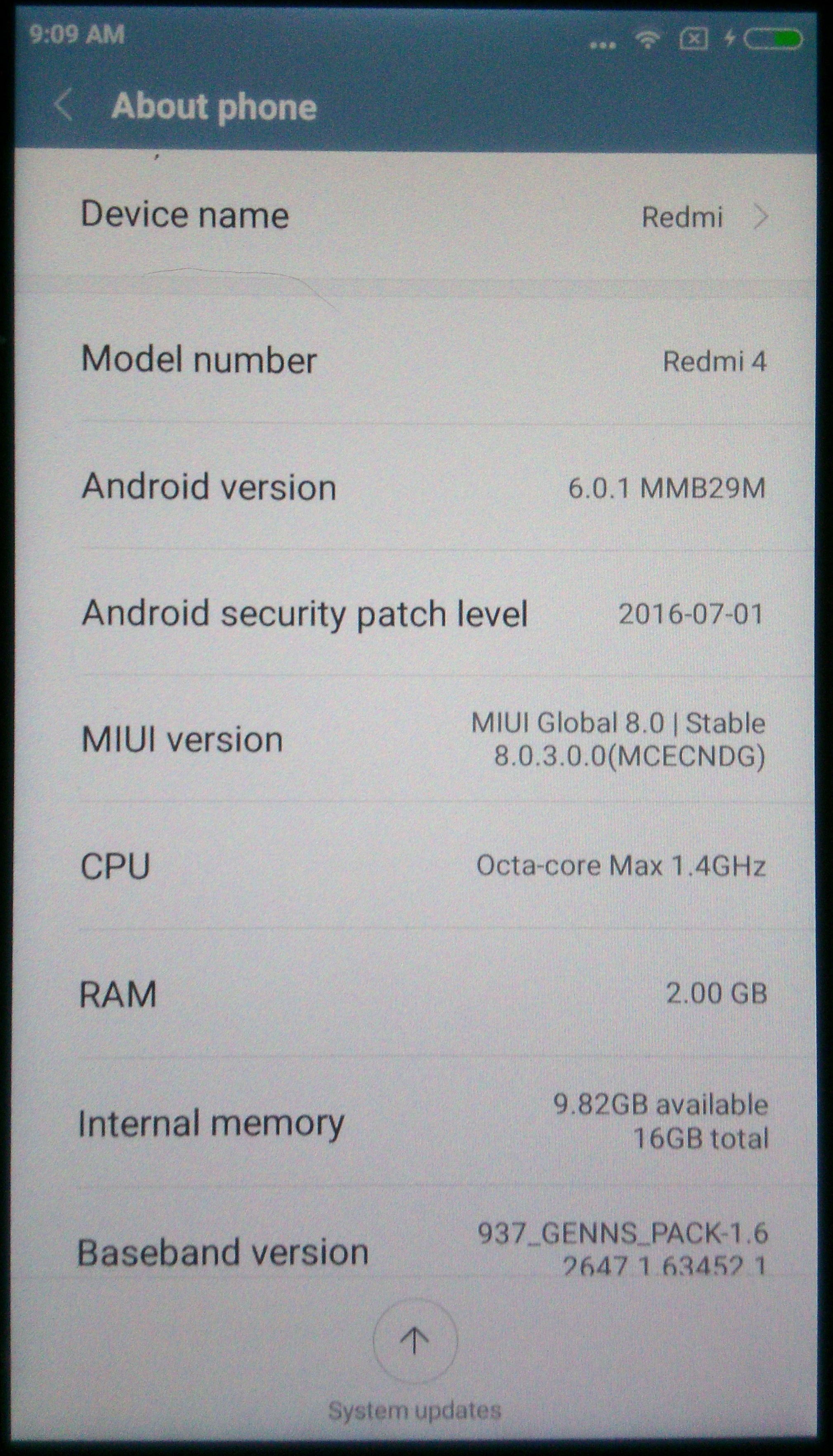

Hey guys here's similar story. I've got my Redmi 4 with some nonofficial kind of outdated 'Vietnamese' ROM which worked fine though. Anyway I decided to unlock bootloader and put in the international ROM as I did in case of my previous Redmi 2, but it failed in the way described above. I can easily upgrade ROMs, but baseband remains the one installed with the first update and it seems it's same in any ROM available here or on Xiaomi.cn. I desperately tried replace HLOS from Redmi 3s, but then radio failed completely even the Wi-Fi didn't work, so that's not the way to go. See screenshots for details. Any help is appreciated.

Problem solved as described under other topic.
Try re-installing the modem as follows:
From the zip file (it is a downloaded rom) extract the file NON-HLOS.bin
Phone in fastboot mode and command:
fastboot flash modem NON-HLOS.bin
Reboot to fastboot mode again and commands:
fastboot erase modemst1
fastboot erase modemst2
fastboot reboot
My Redmi 4 works perfect after that.
