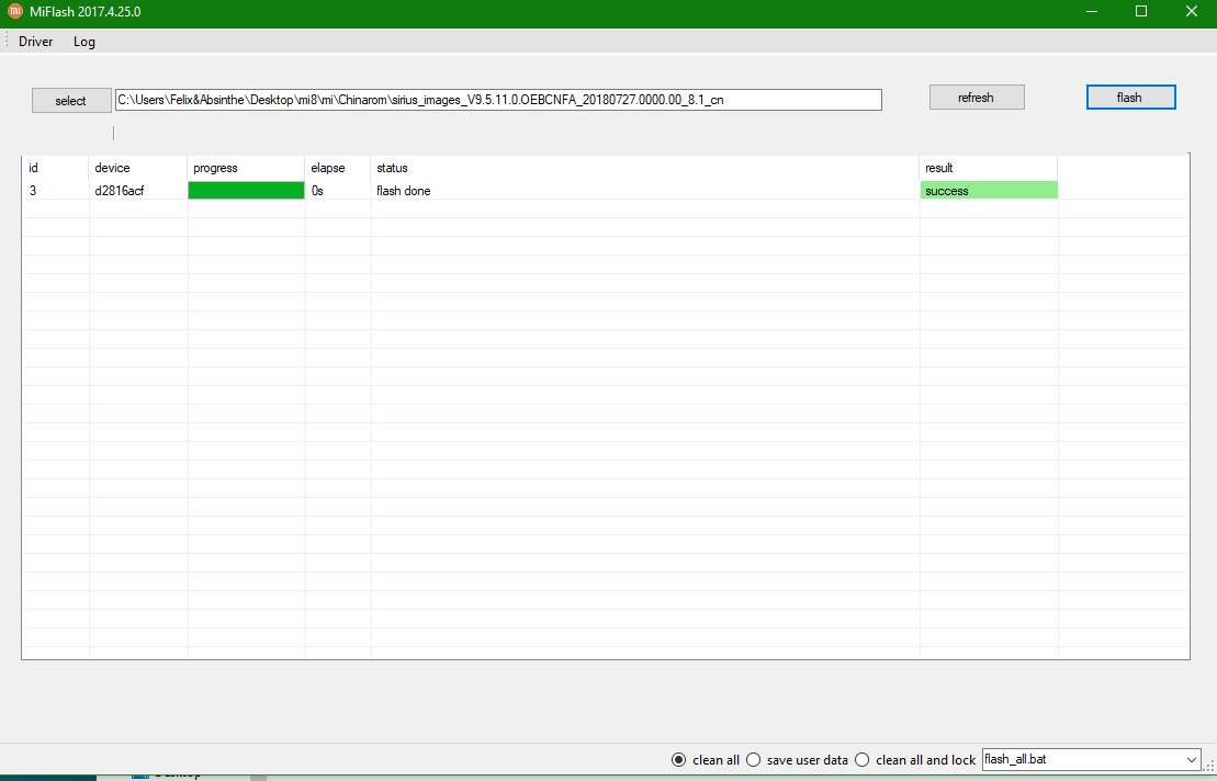

I've tried to flash it via MIFLASH but again... done in 1 second.

Did you refresh MIFLASH status?
SO,
you have the good rom, well unziped and phone connected to adb/fastboot. That must do the job.
Try with another USB port on your computer. USB2 are the best.
Also Move the rom file to another directory.
SO,

still in bootloop... now i just want to install stable rom... but miflash not working... flash in 1 second.
I was kidding!
SO,
