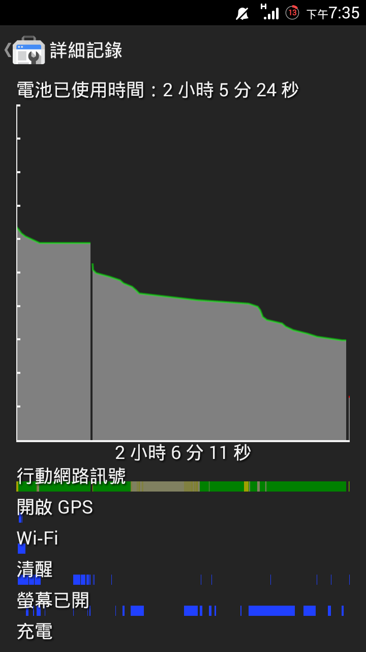

look it, when I change system. the battery has something wrong.
Do u mean the step? Its normal when u reboot or go to recovery
