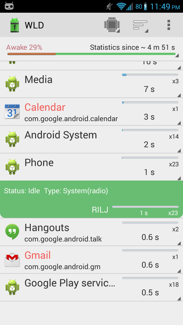

RILJ wakelock still drain my battery. I do all the wipes and works fine until the first reboot after that RILJ wakelocks my mi2 for ever.

Killed RILJ wakelock but it's not a nice "fix".

I created merge requests in CM for RILJ wakelock fixes:
http://review.cyanogenmod.org/54960
http://review.cyanogenmod.org/54961

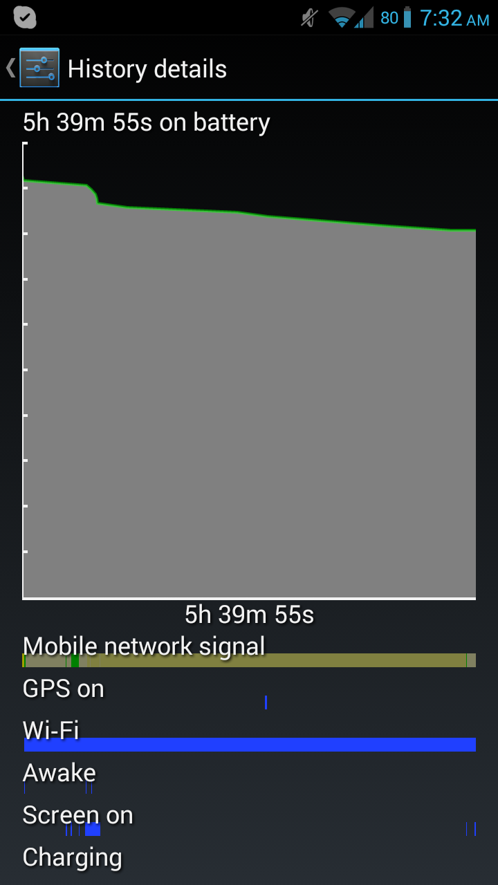

Battery life seems to be great again:
I hope that screenshot is 3G + Wifi hehe.

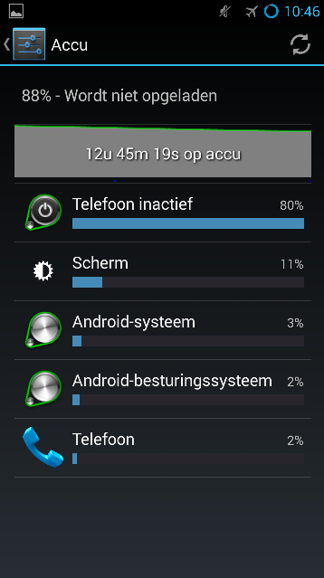

I don't understand why my phone gets this battery drain even when in airplane mode, for as far as I could fine RILJ wakelock does not apply when in Airplane mode?
I tested the battery drain in different situations this weekend (with the 25.13.2013 rom) and even with a fresh boot, no apps running in the background I get this:
About 12% battery drain in 12 hours (Started test with 100% battery) of not doing anything with the phone. That should be like 3-4% max right? (After reboot it says only 84% battery is left)
If I use 2G plus wifi all day I think I can get a maximum of about 12-14 hours of battery out of my phone with moderate use(tested this on friday) while that should be like 25 hours, maybe 30.
Since I don't have mobile internet it is wifi only :)

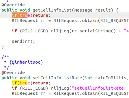

I modify the telephony-common.jar(setCellInfoListRate and getImsRegistrationState method) with apktool,then i launch a lot of apps,such as wechat and chrome,the phone is still hard to deepsleep when i turn off the screen.
