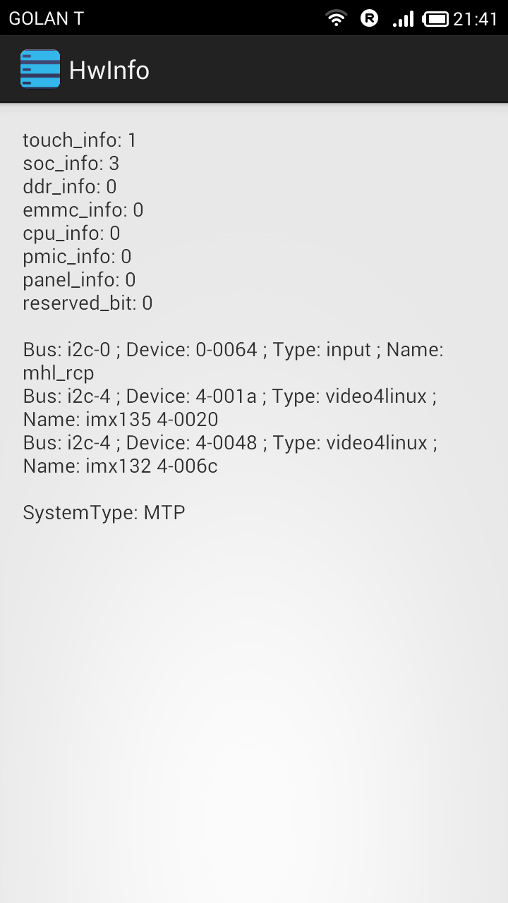

2) if that didn't work maybe u have another touchscreen hardware. pls install hwinfo on your device(on a rom with stock kernel, I know that miui works but I'm not sure about cyańogenmod/aosp) and post a screenshot:

Thanks for the quick reply!
I did try to reboot to recovery and even do a factory restore/dalvik wipe again to no avail.
So here's the screenshot!
Hope you can figure something out from it : )
Thank you for your hard work!
Edit: It does seem to be different from yours and others.
It should be one of the newer revisions as the Xiaomi box it came in has that product authenticity confirmation code thing they have only started using recently.
Ok, the 1th interesting thing is that u have imx135 and imx132 cameras.
And according to this app u don't have any touchscreen :D

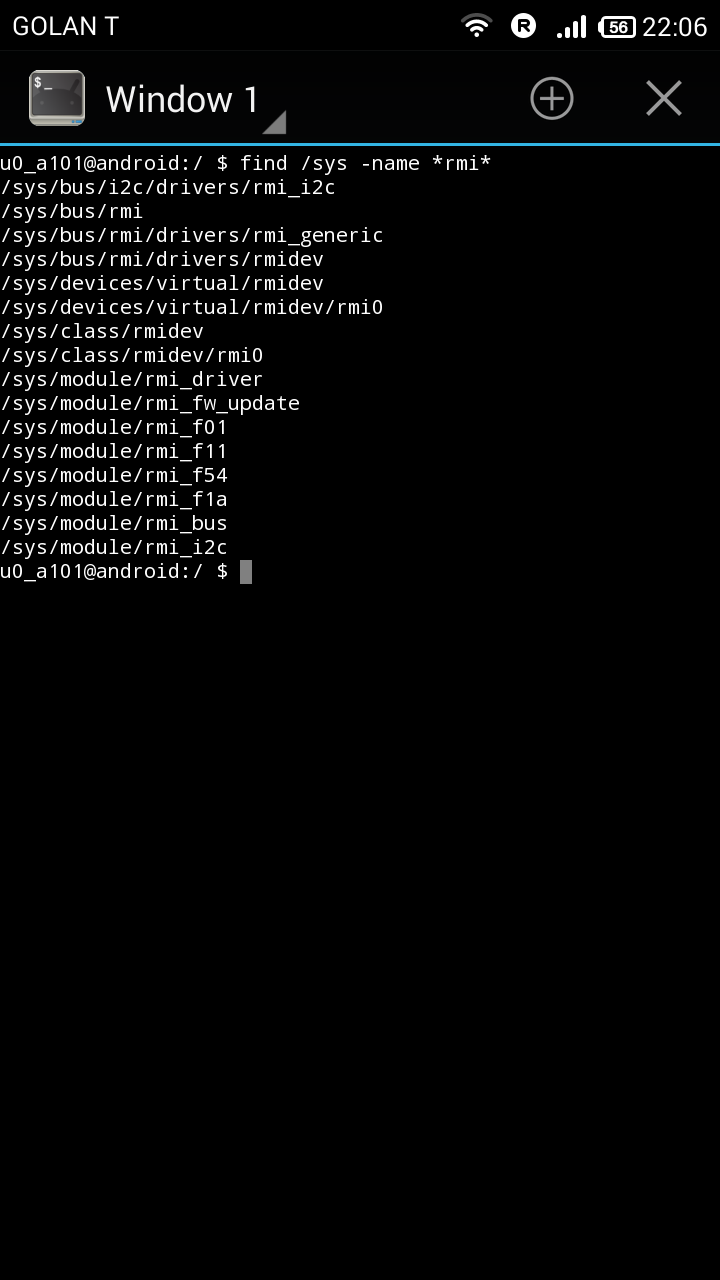

Maybe u have a rmi touchscreen can you post the output of this command?
find /sys -name *rmi*

Oh, right lol
Terminal screenshot.

Great, glad it helps : )
Just a thought though, why is the sourcecode for an Xiaomi touchscreen in a Google git repository? Or is it a Qualcomm thing?
And where is the driver in the terminal output? "rmi_i2c"? Just wondering lol
the fact that there are rmi nodes in /sys/devices tree shows that the driver recognized a device.

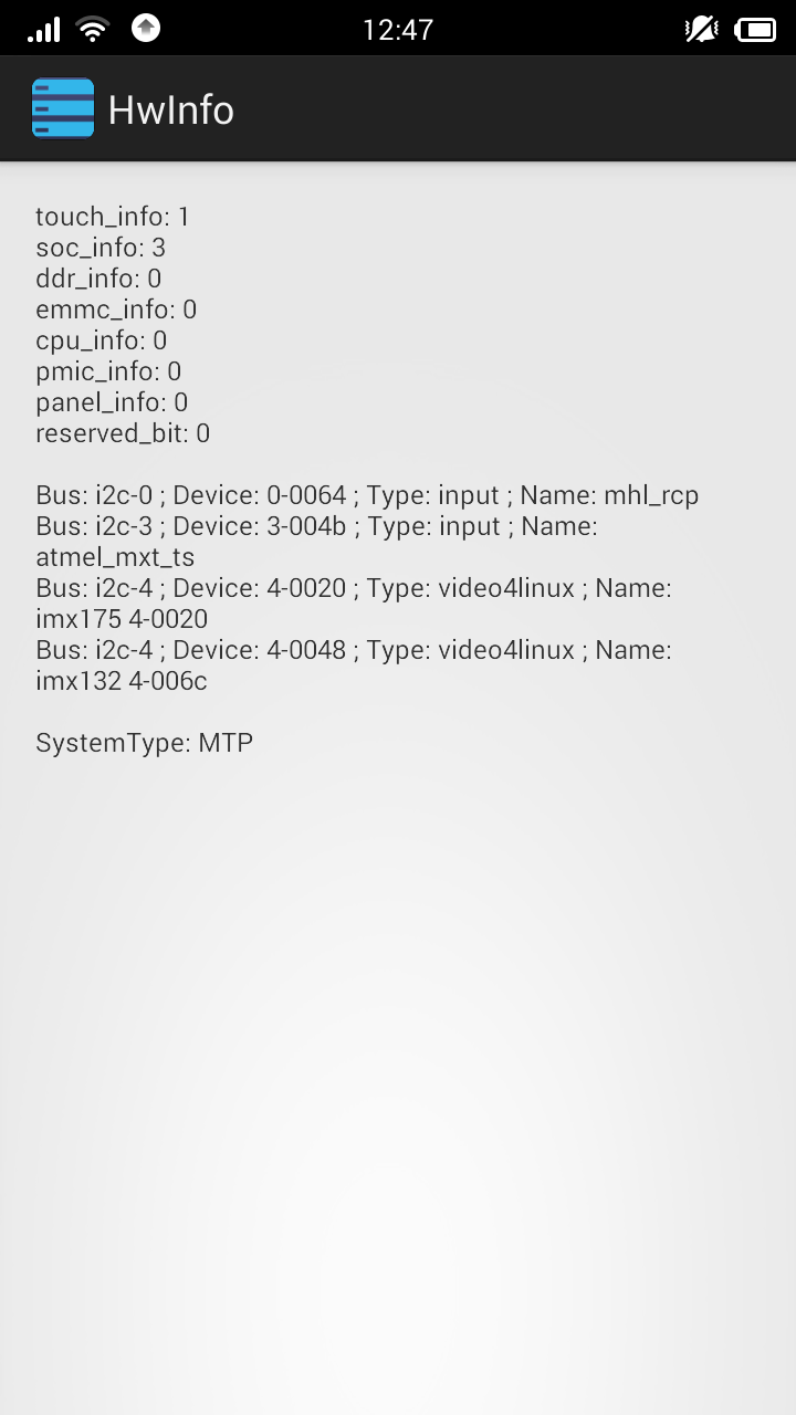

heres mine :) its from a week old phone
the module i have should be the same as the one on Galaxy s3/ Note 2 :) and the front camera is the same as the one on Optimus G (im not 100% sure)
